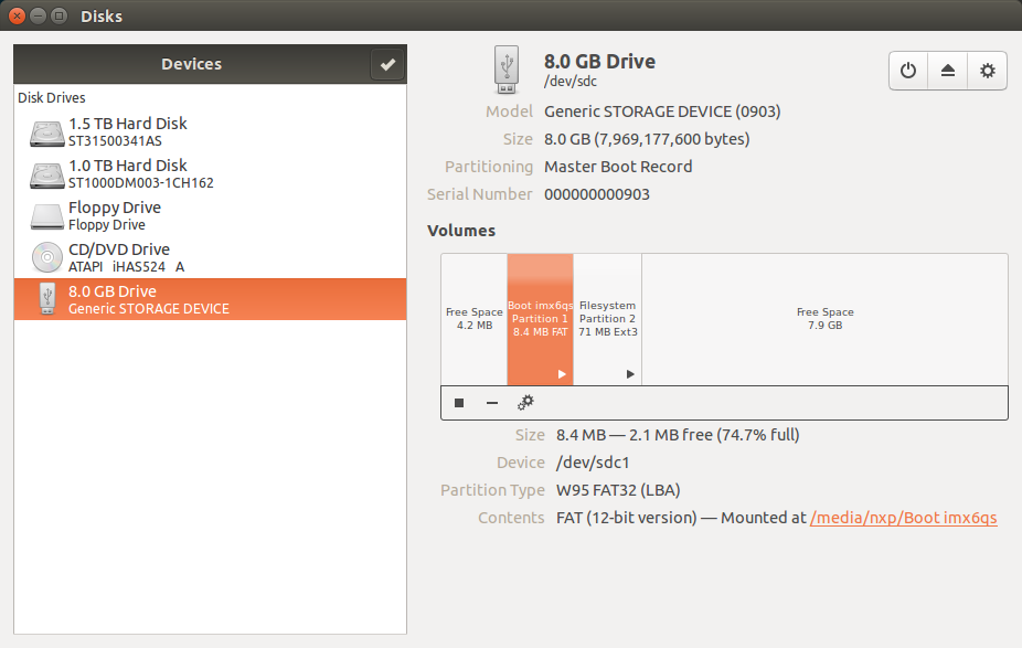

I have the SABRE board for smart devices  6QP.  I need to have the SDcard have the "core-image-base."
I used the Freescale Yocto Project User's Guide, Rev. L_3.14.38_6ul-ga, 09/2015 and successfully build the image and got all the files in ..MYNAME/tmp/deploy/images/imx6qsabresd.
I imaged the SD card as in Section 6.1:
THE DISK UTILITY SHOWS:   (Partition 2 has /bin /home, etc.)

Hi Janet
'imx6q-sabresd.dtb' is for other processor i.MX6Q, while
in that case (processor i.MX6QP) naming *.xyzQP" should be used
for example: zImage-imx6qp-sabreauto.dtb e.t.c.
