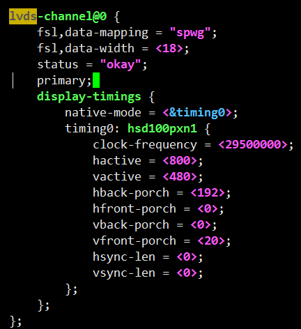

I want LVDS0 as the default display channel.
Android versions:
android M base on linux 4.1.15
my dts configure for lvds0:
when i add the primary of keyword to lvds0,and delete it  in lvds1 :

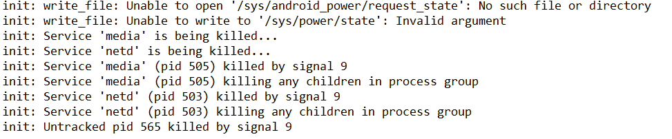

android can't startup,and show:
what can i do for the source code?

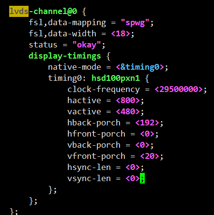

  The problem is solved.I add keyword of primary to lvds-channel0 only,what's more,hsync and vsync can't equal zero in lvds-channel0.
And, i suggest that hsync and vsync are equal to THB and TVB respectively
