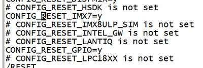

I am currently porting bsp5.10.72, but I always get pcie0 errors. However, it works well in bsp5.4.3.
Could you give me some suggestions?Refer to the official evaluation board im8mm-evk to modify the device tree

The reset controller needs to be enabled as follows:
