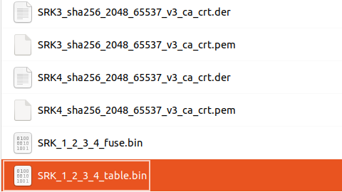

We had downloaded IMX_CST_TOOL_NEW.tgz and after compile it, we executed these commands:
cd /home/test/cst
cd keys
./hab4_pki_tree.sh
no
rsa
2048
5
4
yes
cd ../crts
../linux64/bin/srktool -h 4 -t SRK_1_2_3_4_table.bin -e SRK_1_2_3_4_fuse.bin -d sha256 -c ./SRK1_sha256_2048_65537_v3_ca_crt.pem,./SRK2_sha256_2048_65537_v3_ca_crt.pem,./SRK3_sha256_2048_65537_v3_ca_crt.pem,./SRK4_sha256_2048_65537_v3_ca_crt.pem -f 1

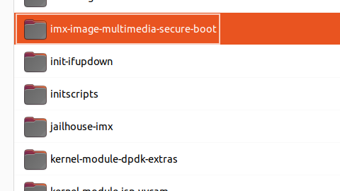

DISTRO=fsl-imx-xwayland MACHINE=imx8mpevk source imx-setup-release.sh -b <name>
bitbake-layers add-layer ../sources/meta-nxp-security-reference-design/meta-secure-boot
Add CST in CST_PATH in local.conf.
echo "CST_PATH = \"/home/test/cst\"" >> conf/local.conf

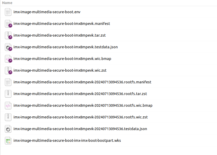

bitbake imx-image-multimedia-secure-boot
bitbake imx-boot-signature
bitbake linux-imx-signature

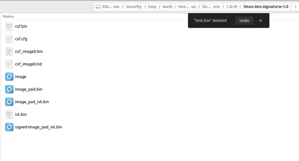

I had expected to get signed image and I got.
Then we started to load images to board using serial download port and it was successful.
But we tried to check signed image in development mode and we got error as I mentioned.
According to document AN4581 it explains how to generate srk_fuse and srk_table. However it talks about Creating the CSF description file but it doesn’t explain how to create IVT.bin.
I didn’t find anything about it in: i.MX Porting Guide, i.MX Linux User's Guide, IMX8MPSRM or other documents including : AN12056 or AN12263. By the way, these documents explains DEK_blob and hab_rvt that as I have found they are old, also the commands like hab_rvt.authenticate_image and hab_rvt.entry() doesn’t exist anymore.
In conclusion, I need to know how to create IVT_boot_data.bin, how to do padding for image, and how to sign an image… It’s better to say a complete steps to create chain trust and check it before burning the efuse.
820 Views
Harvey021
Without burning SRK hash, will not get complete authentication, like will not be able to authenticate SRK table against fuses, but Target will still authenticate image that signed by automation against the keys.
