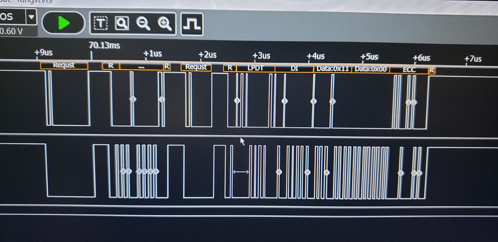

the driver file below may:
//dsi->mode_flags |= MIPI_DSI_MODE_LPM;
when I test it is set as LP Mode, and I can get the MIPI-D0+/-  signal well .But the signal is not correct,it is incomplete, even short writes.
I don't know why.
Then I test the rm67191(MX8_DSI_OLED1),and I find almost all the cmds is 2 bytes short write.
why ?
would you pls send me the panel driver file of rm67191?(not the datasheet for the panel,I have got it)
there is some error while with more the 2 bytes .

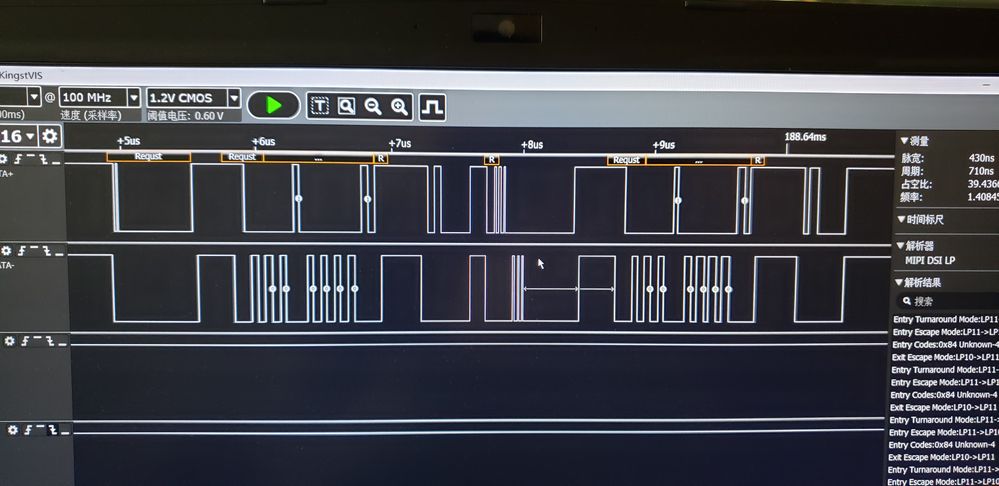

Hello everyone ,
FIXED ! st7701s LCD WORKs
We succeded bring the st7701s on linux :
  • 2 mipi-dsi lanes ( 1 clock , 2 lanes )
  • IMX8m Plus Soc
  • Linux ( yocto , kernel 5.4.24 )
The general idea was :
  • 1° Pay attention to the rst pin level , the driver should let it HIGH when using the lcd
  • 2° The init sequence need to be sent in LOW POWER DSI mode
  • 3° The header and payload of each packet has to be wrote according to the driver's datasheet ->
    • 3.1° Pay attention to the Data_id in each DSI packet ! , to stick to the Data_id and low power mode we do not use " mipi_dsi_generic_write " to send the init sequence , instead we use a custom function that look like this :
ssize_t DcsPktWrite(struct mipi_dsi_device *dsi, u8 DCS_DI, u8 Len, u8* Ptr)
	printk(KERN_INFO "---** BOURS **---  DcsPktWrite ENTER");
		struct mipi_dsi_msg msg;
		msg.channel = dsi->channel; // DSI channel from device ( 0 in most case, I think )
		msg.tx_buf = Ptr;       // payload to send in the DSI packet
		msg.tx_len = Len;          // size of the payload to be sent
		msg.flags = MIPI_DSI_MSG_USE_LPM; // only in low power mode ( init sequence has to be done in low power mode , often the case for LCD panels I think...  )
		//.flags =0,
		msg.type = DCS_DI; // the init sequence already give the right "DI" aka "Data ID" , of the DSI DCS protocol
		msg.rx_len = 0;
		msg.rx_buf = NULL;
		printk(KERN_INFO "---** BOURS **---  DcsPktWrite RETURN ");
		//return 0xDEAD;
        return mipi_dsi_device_transfer(dsi,&msg);
  • 3.2° : The init sequence we got from our panel manufacturer give the Data_id code for each packet , these are :

fangkai
Hi igor,
         I'm very glad to receive your reply.
I have tried to modify the manufacturer_cmd_set[],and add some prints to show it works.
the cmds I need to send:
unsigned char ST7701S_CMD_TABLE_BK0[]={0xFF,0x77,0x01,0x00,0x00,0x10};
unsigned char ST7701S_CMD_LNESET[]={0xC0,0x4F,0x00};
log:
                     Enter rad_panel_enable ...
[ 1.508806] Send cmd exit slp in rad_panel_enable.
[ 1.518847] Enter rad_panel_push_cmd_list.
[ 1.518850] current cmd lenth 6.
[ 1.518852] send 0xff 0x77.
[ 1.518872] send 0x1 0x0.
[ 1.518891] send 0x0 0x10.
[ 1.518909] current cmd lenth 3.
[ 1.518911] send 0xc0 0x4f.
[ 1.518929] send 0x0.
becaues the data length more than 2 ,it will be an error(I don't know why).
so all the cmds is send 2 by 2,
I don't know it works or not to the panel.
and 1st ,I should sent the cmds.
but the signals on data lane 0 is not correct,while the log seems no error.
and the right one on panle rm67191 is as below:  (CMD: SLP_OUT)
I really need some help on how to modify the driver files.
Thank u
