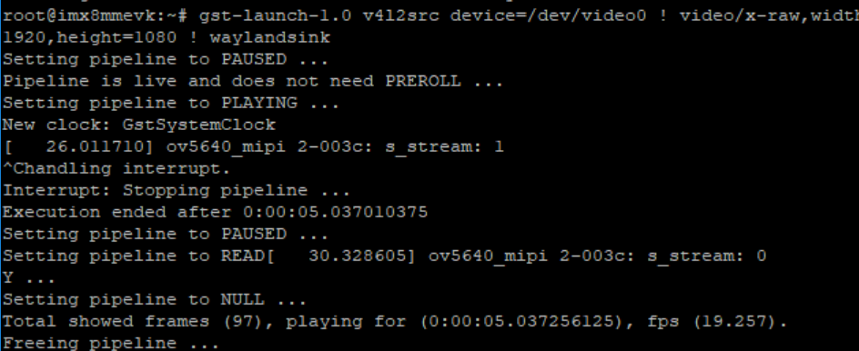

gst-launch-1.0 v4l2src device=/dev/video0 ! video/x-raw,width=1920,height=1080 ! waylandsink
works on the NXP-provided L4.14.90_2.0.0_ga_images_MX8MMEVK/fsl-image-validation-imx-imx8mmevk.sdcard.

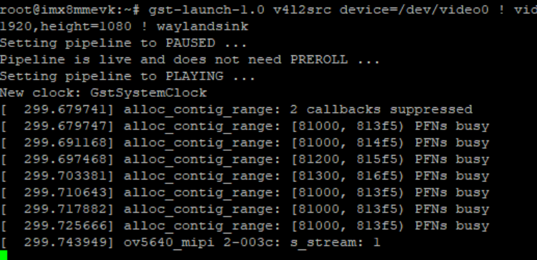

However, if I use Yocto to build the image using:
DISTRO=fsl-imx-wayland MACHINE=imx8mmevk source fsl-setup-release.sh -b build-wayland
bitbake fsl-image-validation-imx
I just get a black screen with the above gst-launch-1.0 command:
Any advice?

Problem solved.
gstreamer does not work properly with the this DISTRO.
I have to use:
DISTRO=fsl-imx-xwayland MACHINE=imx8mmevk source fsl-setup-release.sh -b build-xwayland
I have seen comments in community.nxp.com where people have said fsl-imx-wayland is ok, but it really depends on what you are trying to do. Just note, I have found gstreamer does NOT work with this. You need to use fsl-imx-xwayland. I don't know the exact root cause (already spend countless hours building different recipes), but hopefully this helps the rest of you.
