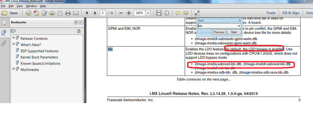

BiyongSUN
If you have read i.MX_Linux_Release_Notes.pdf, you will find
For example:
ldo bypass: imx6q-sabresd.dts
ldo enable :imx6q-sabresd-ldo.dts
This dts ldo bypass needs uboot to support.
