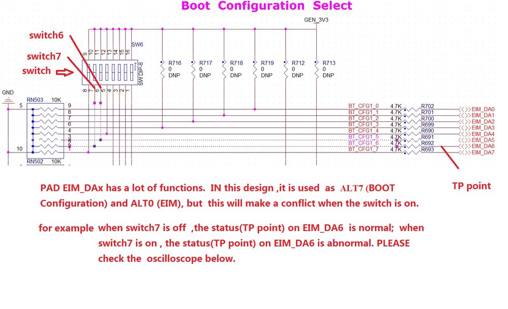

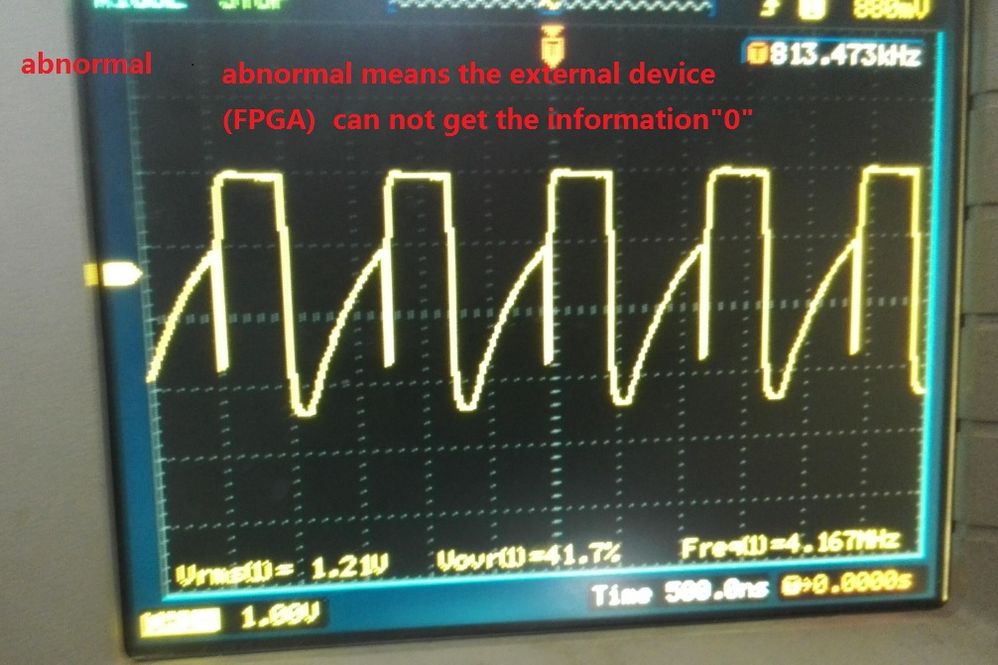

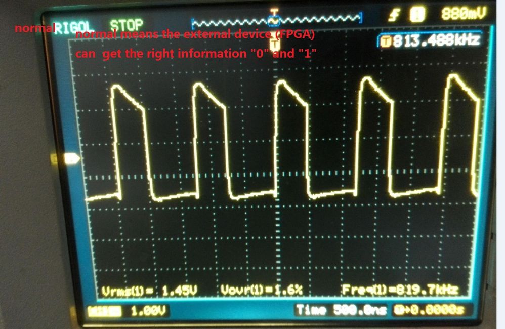

Q:How to end this confilict?

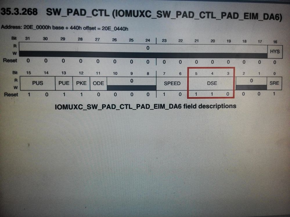

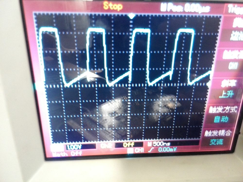

  I replaced 4.7kΩ with 18kΩ, the wave form changed. I think the problem is drive strength of EIM signals.so I reconfigured the DSE(drive strength field),but it didn't work. Can you give me some advice?
2,743 Views
Yuri
   The Boot  Configuration Select with resistors just provides 4.7 kΩ pullup, when
the switch is ON. Basically this should not affect EIM signals, if outputs are strong
enough to overdrive 4.7 kΩ.

how to make it strong enough?
2,743 Views
Yuri
The following app note helps to setup pin’s electrical properties.
“Influence of Pin Setting on System Function and Performance”
< http://www.nxp.com/files/32bit/doc/app_note/AN5078.pdf >
