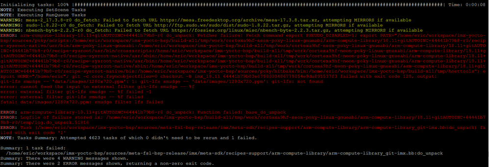

I use latest 4.14.98_2.0.0_ga version and try to build an image for imx6qp Sabre board
I use bitbake fsl-image-validation-imx command
Host system  Ubuntu 16.04
Here is part of log:
git -c core.fsyncobjectfiles=0 checkout -B imx_18.11 64441b79b83e0790008486779054e9da891537f3 failed with exit code 128, output:
git-lfs smudge -- 'data/images/1280x720.ppm': 1: git-lfs smudge -- 'data/images/1280x720.ppm': git-lfs: not found
error: external filter git-lfs smudge -- %f failed -1
fatal: data/images/1280x720.ppm: smudge filter lfs failed
ERROR: arm-compute-library-18.11+gitAUTOINC+64441b79b8-r0 do_unpack: Function failed: base_do_unpack
if I try to execute commands just in command line all works fine.

jay_park
I got a same issue and solve it by adding a symbolic link of git-lfs in build/tmp/hosttools directory.
imx-yocto-bsp/build/tmp/hosttools$ ln -sf /usr/bin/git-lfs git-lfs
Hope it helps you.

gn02380756
Hi Radhika Somaiya:
I faced the same problem when building imx6qsabresd, following is my error log.
I'm sure I had installed git-lfs, but the error still occurred. Can you please solve this problem? Thanks!

q325mg
I have the same issue but with IMX8 QXP MEK
Were you able to fix it alexeymodyanov
Edit:
The way it worked for was: the first time I was using Ubuntu 16, and tried to create the image on a restricted network, so I had to manually disable SSL from git and https from python, and I got the error, then instead I created a clean new Ubuntu 18 installation and did the build on a unrestricted network and it worked

radhikasomaiya
Senior Contributor II
Hi  Alexey Modyanov,
We are able to build image successfully for imx6qpsabresd by following the steps of attached Yocto User's guide version L4.14.98_2.0.0. Can you please try to fresh build?
For git-lfs: not found error, you can try to install git-lfs.
Refer this link for git-lfs installation.
