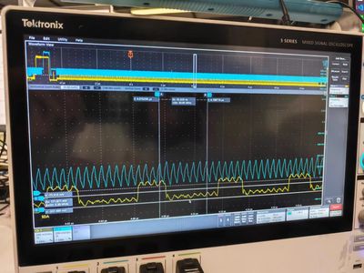

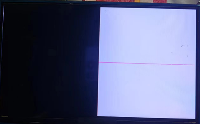

sean33996
i get the DSI signal by oscilloscope
and the sn65dsi86 color bar is succes on the screen
but the dsi signal can not on the screen
Could you give me some advice

Zhiming_Liu
1.Check dts setting with your hardware design again
2.You can use i2ctool to dump sn65dsi86 registers and check if there is any error flags.
2,007件の閲覧回数
sean33996
thank you very much , it works
