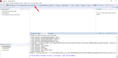

I'm using the MIMXRT685-EVK and going through the eIQ tutorials. Hitting unexpected compilation errors when running the imported project (see attached) on the DSP core. The guide I'm following is https://community.nxp.com/t5/eIQ-Machine-Learning-Software/Getting-Started-with-TensorFlow-Lite-for-... for the RT685. Any guidance here would be helpful, thanks!

Which version of the SDK library did you test with?

This is the console output for when I try building both the `tensorflow_lite_micro_cifar10_hifi4` and `tensorflow_lite_micro_label_image_hifi4` by directly importing the projects from SDK_2_12_0_MIMXRT685S. I double checked the Linked Resources and the Project's source files and confirmed that the file paths for these errors are accurate as well.
Since I didn't change anything after importing the projects and it was complaining at an auto-generated Makefile, not sure what else I can modify to correct this.
I also attached the Console log with some verbose options enabled (first `-include` in Makefile and first `-include` that fails).

Please assure the meet below requirement.
- Xtensa Xplorer 9.0.18
- Xtensa C Compiler 14.01
Actually, I've not met the error you mentioned.

How do I find the Xtensa C Compiler version? My Xtensa Xplorer is 9.0.18

1) How do I find the Xtensa C Compiler version?
-- When installing the Xtensa Xplorer, the corresponding compiler will be installed at the same time, in another word, the Xtensa C Compiler 14.01 was installed if you already installed the Xtensa Xplorer 9.0.18.
