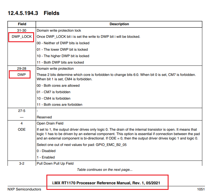

请问,如何利用MCUXpressoConfigTools为Pquestion.pngAD配置DWP 、 DWP_LOCK功能?

Hi @freedomLi ,
No, configtool can't set these bits. You have to set them in your code.
Jing
