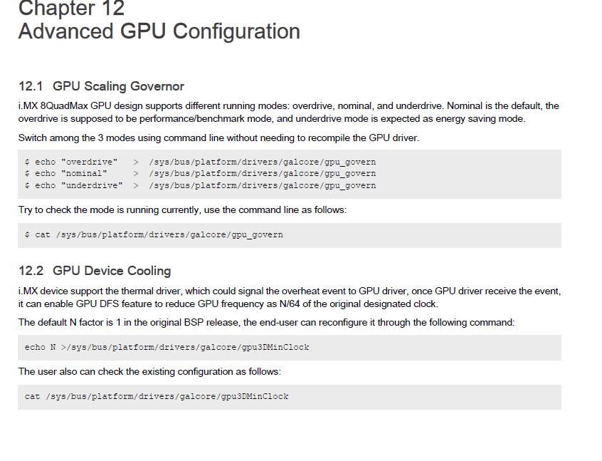

For the cpu, you can use the DVFS CPU governor.
It is pure linux knowledge, not for this i.MX Processor. it is the same linux knowledge for X86/X64.
For the gpu, please read the BSP release document to use
GPU DFS
