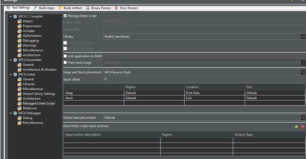

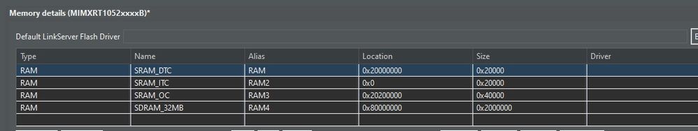

I'm trying to declare variables in SDRAM using:
__DATA(RAM4) int var[SIZE_2MG];
and
__attribute__ ((section(".data_RAM4" ".$RAM4"))) int var[SIZE_2MG];
I receive this error:
borrar2.axf section `.data' will not fit in region `SRAM_DTC'
My Memory settings is:
I'm a beginner in NXP developing, please help me.
