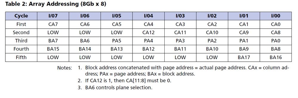

It could be the row address cyles. Now I have value 3 and as I see in table 2 of the datasheet it should be 2. is it correct, I'm not sure I understand the table2.

igorpadykov
Hi  Diego
Table 2 shows 3 rows cycles (3,4,5). One can try nand programming using mfg tool
i.MX 6 / i.MX 7 Series Software and Development Tool|NXP
may be useful to look at nand boot debug steps
https://community.nxp.com/thread/307723
igor

igorpadykov
Hi  Diego
I think your settings are correct.
    BOOT_CFG1[5] - for toggle more please check sect.4.10.3 Samsung Toggle Mode AC Timing
    i.MX6SDL Datasheet
http://www.nxp.com/docs/en/data-sheet/IMX6SDLCEC.pdf
    BOOT_CFG2[7:5] for toggle nand, MT29F8G08ABACAH4 is raw nand
    BOOT_CFG1[1:0] raw cycles can be found in MT29F8G08ABACAH4 datasheet Table 2: Array Addressing
    BOOT_CFG2[0] default setting will be fine
