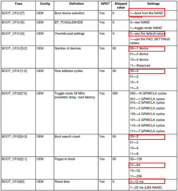

My target is boot from NANDFLASH, the chip is MT29F8G08ABACAH4-IT:C. So, I have to program the fuses in BOOT_CFG1 and BOOT_CFG2, as table 8-10 of the reference manual show. I would like to be sure, before programming fuses because I only have a few prototypes of my custon imx6solo board.
I paste an image with the values I think are correct squared in red color.
  • BOOT_CFG1[7]: Obviously this bit need to be 1 to indicate boot NAND.
  • BOOT_CFG1[5]: I don’t understand this bit, ¿What is the value that I need to put in?
  • BOOT_CFG1[4]: I understood this fuse is for config IO pad settings, so for now I am going to leave as 0.
  • BOOT_CFG1[3:2]: I only have one chip in mi design, so this fuse will be 00.
  • BOOT_CFG1[1:0]: Row Address Bytes. I don’t understand this bit, but the “kobs-ng” command in linux say that “row_address_size = 3”, if this info is related whit this fuse I think the value need to be 00.
  • BOOT_CFG2[7:5]: I don’t know what is my optimal value, and I don’t understand these fuses. ¿Are related with BOOT_CFG1[5]?
  • BOOT_CFG2[4:3]: For now I leave these fuses as 00, But I think it could be 10 since “kobs-ng” repeat 4 times the FCB structure.
  • BOOT_CFG[2:1]: These fuses need to be 01 since the nand flash datasheet says that chips has 64 pages per block.
  • BOOT_CFG2[0]: I don’t understand this fuse, but for now I leave as 0.
Assuming RAW mode, 16 GPMICLK cycles, reset time 12ms, the values for BOOT_CFG1 and BOOT_CFG2 are:

=>fuse prog 0 5 0x00000280
Questions:
  1. Is it necessary program some fuse in BOOT_CFG2 or BOOT_CFG3, or other fuse to boot form my nand?
  2. Is the fuse uboot command correct (fuse prog 0 5 0x00000280)?
  3. Please, could you give me the values for fuses that I don’t understand? And a brief explication:
  • BOOT_CFG1[5]
  • BOOT_CFG2[7:5]
  • BOOT_CFG1[1:0]
  • BOOT_CFG2[0]

igorpadykov
Hi  Diego
Table 2 shows 3 rows cycles (3,4,5). One can try nand programming using mfg tool
i.MX 6 / i.MX 7 Series Software and Development Tool|NXP
may be useful to look at nand boot debug steps
https://community.nxp.com/thread/307723
igor
3,881 次查看
igorpadykov
Hi  Diego
I think your settings are correct.
    BOOT_CFG1[5] - for toggle more please check sect.4.10.3 Samsung Toggle Mode AC Timing
    i.MX6SDL Datasheet
http://www.nxp.com/docs/en/data-sheet/IMX6SDLCEC.pdf
    BOOT_CFG2[7:5] for toggle nand, MT29F8G08ABACAH4 is raw nand
    BOOT_CFG1[1:0] raw cycles can be found in MT29F8G08ABACAH4 datasheet Table 2: Array Addressing
    BOOT_CFG2[0] default setting will be fine
igor
