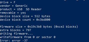

Hi everyone,
I have a problem with the custom board with iMX6S5 processor.
I built the firmware SDK bare metal code and then trying to flash the binary file into SD Card with the "cfimager_imx.exe" as follow the example "uart1_led".
However I get an error as the ouput in the image follows:
I have no idea about the error -37, can someone here help me to figure it out ?

Hi Minh
this error is FAILED_TO_WRITE_SECTOR , one can try other sd card
or with other card reader.

minhnguyen
Hi Igor,
I tried other new 2GB SD cards or with other card reader, the error -37 still happen.
I tried with other file system format types (NTFS or FAT32), the error still occur.
Nguyen.

igorpadykov
Hi Minh
had you checked sect.4.Hardware setup to use CFImager.exe
CFImager_UserGuide.doc included in sdk, so correct drive letter was used.

minhnguyen
Hi Igor,
Thanks for your support.
Now I can create the boot SD Card, however if the firmware binary is big (around 27 MB), I have again the error -37.
With just the testing firmware around 2MB, it's work well.
Do you have any ideas about this? Does CFImager_imx.exe have limit for the binary?
