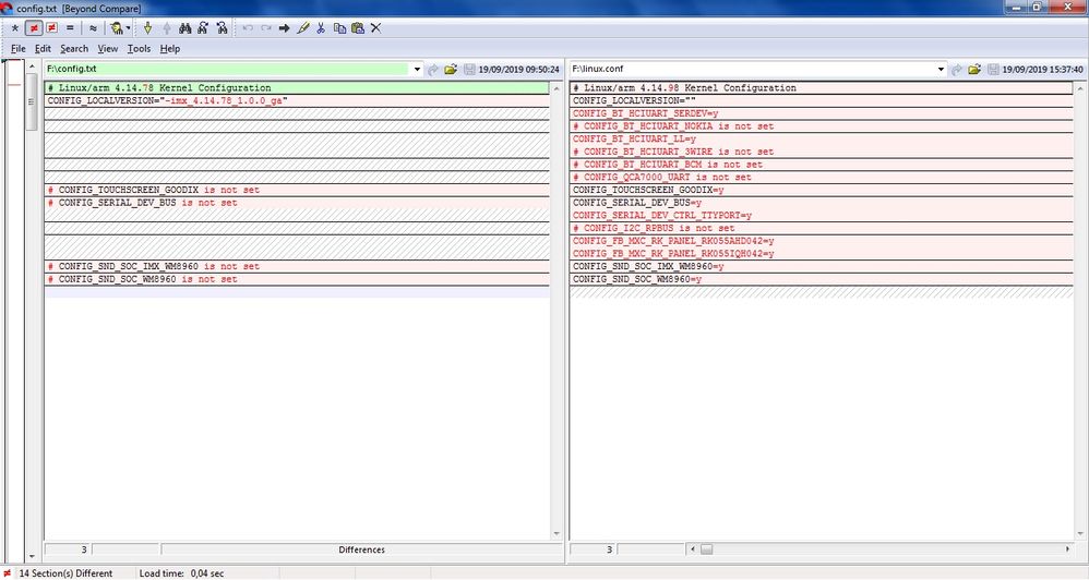

By enabling the CONFIG_BRIDGE it worked for me. Kindly check the config attached and compare with the config that you are using. Let me know if there is anything significant difference between the two.
Karan Gajjar
11,440 Views
sergio_dorazio
Hi, there are few small differents
I send you the differences ....
what do you think , what do I can see ?
Regards.
Sergio.
11,440 Views
karangajjar
Senior Contributor II
Hi sergio d&#39;orazio,
The config that are different don't affect brctl. We also checked the on the kernel version that you using 4.14.98. Still things worked for us by just adding IMAGE_APPEND in local.conf and enabling CONFIG_BRIDGE in kernel.
