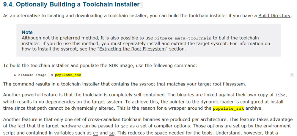

bitbake core-image-x11 -c populate_sdk
a valid command?What is the output file format?I want to make a gui using qt

BiyongSUN
For the yocto questions, you can check the yocto project.
Yocto Project Mega-Manual
