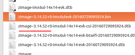

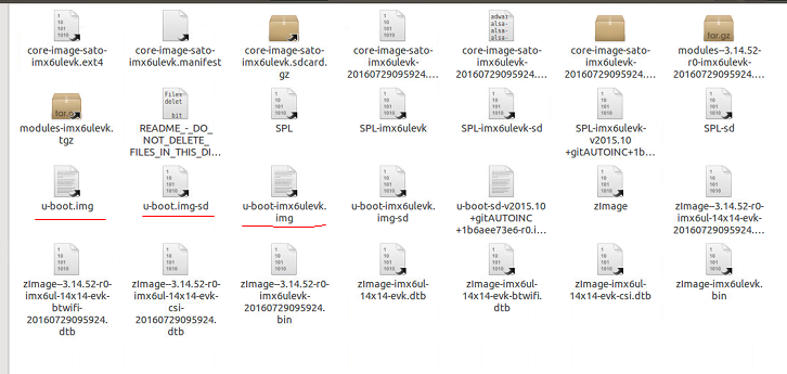

after  bitbake core-image-sato.(done)
i got the files :
i want to using the mfgtool on pc ,no u-boot.imx.

i have tried this:
bitbake -c clean u-boot (done)
bitbake -c patch u-boot (done)
bitbake -c compile -f u-boot (error)
there was no error ,  no u-boot.imx.
u-boot-fslc was the same phenomenon。
only the u-boot-imx i can got u-boot.imx
but what's the mean of the error,why?

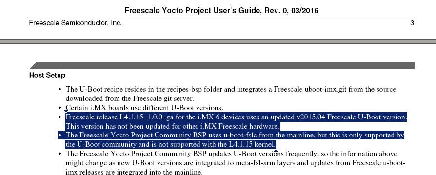

igorpadykov
u-boot.imx can be found
http://git.freescale.com/git/cgit.cgi/imx/uboot-imx.git/tree/?h=imx_v2015.04_4.1.15_1.0.0_ga
regarding differencies please check attached Yocto Guide
sect.5.5 U-Boot configuration, sect.3.1 Host packages and link
https://community.freescale.com/message/402940#402940
igor
