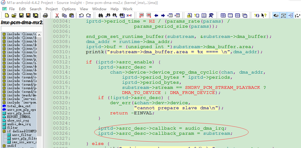

hi ,
   I use asrc. The audio path is mem->dma-> asrc->dma->ssi. I use two dma channel. But the dma irq of callback is not execute. I don't know why. Can someone help me?
Our codec use ak7738 (dsp). The code in the attachment.
Original Attachment has been moved to: imx-ssi.c.zip
Original Attachment has been moved to: imx-iflyout0.c.zip
Original Attachment has been moved to: imx-pcm-dma-mx2.c.zip

igorpadykov
seems similar configuration "mem->dma-> asrc->dma->ssi" is used
on ESAI codec CS42888 SCH-26662  p.5 on Sabre AI board
Schematics (5)
Design files for i.MX 6Quad and i.MX 6DualLite CPU1 Cards
Design files for Base Board (REV E)
http://www.nxp.com/products/software-and-tools/hardware-development-tools/sabre-development-system/s...
and one can look at its implementation in attached Linux Manual sect.
29.2.2 Sequence for Memory to ASRC to Peripheral.
igor
