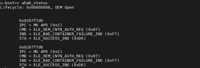

I'm doing the secure boot on imx93. I use Yocto with meta-nxp-security-reference-design/meta-secure-boot meta layer, which supports i.MX boot image signing automation to compile the signed uboot and kernel container.

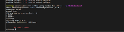

First time, i referred to the ahab document and generated the ecc sha384 keys, and got the signed uboot and kernel container. I flash it to first board and run ahab_status, it succeed
Second time, i generated the rsa-2048 sha256 keys, and every steps else is the same with the first time. I flash the signed uboot and kernel to second board and run ahab_status, it failed, shows
0x0287f7d6
IPC = MU APD (0x2)
CMD = ELE_OEM_CNTN_AUTH_REQ (0x87)
IND = ELE_BAD_CONTAINER_FAILURE_IND (0xF7)
STA = ELE_SUCCESS_IND (0xD6)
I'm really confused why it can't work with the rsa keys, and what does the failure indication mean? I think the imx93 and ahab support both ECC and RSA, and i really follow the same step, just key type are different.
I am very eager to get your support and help! Thanks in advance!

This issue has been resolved. As the IMX93 Reference Manual say, it support rsa-pss and ecc key, but not rsa key, so it is clear that imx93 doesn't support rsa type keys.

That is correct, no RSA with ele device.

Probably a cause as like " By default, the NXP CST Signer Tool uses standard keys of type ECC P256-SHA256 for i.MX 8/8x/8ULP/9 Family" as stated from <10.9.2 Prerequisites for preparing a signed image
