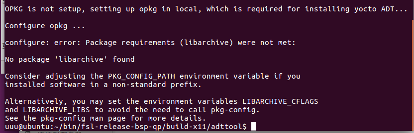

hello,
today i try to install adttool using the ADT Installer.
after i selected the default directiory and select silent mode, there is a problem that says: no package 'libarchive' found.
then i enter the command: "git clone git://github.com/libarchive/libarchive" and  tried again,
the same problem occures.
Labels (2)
2,236 Views
marshall123
OK, I solved it myself by apt-get install libarchive-dev

gusarambula
Hello q y,
I'm glad you found a solution. Thanks for posting it so it can benefit other Community users.
