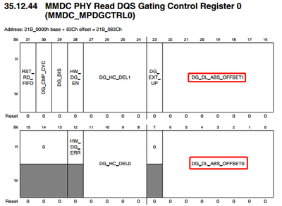

But some calibration values may vary each run on the same board or run on different boards.
eg.
MPDGCTRL0 PHY0 (0x021b083c) = 0x4154014C
MPDGCTRL0 PHY0 (0x021b083c) = 0x41500148
MPDGCTRL0 PHY0 (0x021b083c) = 0x414C0148
How do i choose this calibration value? the max one? the min one? or average of the 3 values?
