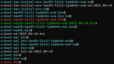

Hello everyone,
I am currently trying to enable the verified boot feature in U-boot in order to boot a signed FIT image. I am working with the i.MX93 EVK and Yocto Kirkstone release.
My goal is to configure "local.conf" file so that after building the image I get a u-boot image with public key added to it. I want to secure the process of passing from u-boot to linux (in FIT format). To do so I have configured the "local.conf" as follows (info related to u-boot verification is provided only):
# to use FIT image for kernel and devicetree
MACHINE_FEATURES += "fit"
#signing key
UBOOT_SIGN_KEYDIR = "/home/gorka/timesys/bad_keys"
UBOOT_SIGN_KEYNAME = "dev"
# Sign FIT image
UBOOT_SIGN_ENABLE = "1"
# generate new signing key if not exist
FIT_GENERATE_KEYS = "1"
# Uboot mkimage option
UBOOT_MKIMAGE_DTCOPTS = "-I dts -O dtb -p 2000"
While compiling the next warning is shown:
WARNING: u-boot-imx-2022.04-r0 do_deploy: Failure while adding public key to u-boot binary. Verified boot won't be available.
And if I take a look at deployed files:
There u-boot binary is shown (with dtb and without dtb). And the dtb itself appears twice as symbolic links. But the real u-boot.dtb file isn't available.
I have compiled it twice with different keys and compared both u-boot.bin files, but they don't differ so I guess that the public key isn't hardcoded (as the warning had adviced).
Is there any way to solve it? Is it something wrong in "local.conf"?
Thank you in advance,
Gorka.

Harvey021
Please have a reference to the <10.9 Security reference design> of IMX_LINUX_USERS_GUIDE.pdf
Harvey
