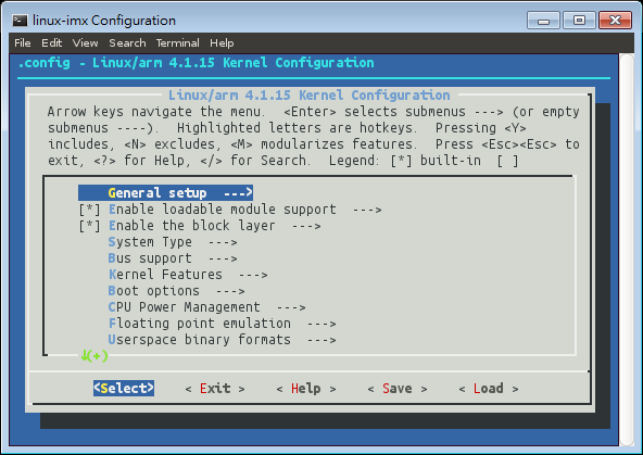

I'm working on i.MX6 sabre-SD Dual lite and build Yocto image.
I connect to my server to build source code via putty from my windows computer.
While I trying to modify my defconfig, I execute below command.
bitbake linux-imx -c menuconfig
However, It did not show manual out like below picture.
It will stuck at do_menuconfig(below picture)
If picture is no clear please refer to below attachment.
How can I solve this problem?

marcomadrigal
Try:
bitbake virtual/kernel -c menuconfig
Also, in your picture it looks it is executing correctly, how long did you wait? Depending of your system it should take some time before opening the configuration window.

Hi tsung,
Change the command to:
bitbake -c menuconfig linux-imx
If the problem persist please check:
https://community.nxp.com/thread/376369
