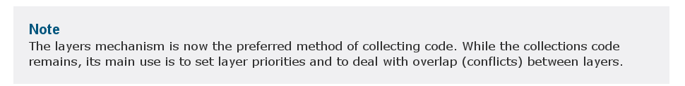

I'm confused about the use of BBFILE_COLLECTIONS variable and BBFILE_PRIORITY inside layer.conf.
The bitbake user manual http://www.yoctoproject.org/docs/1.8/bitbake-user-manual/bitbake-user-manual.html just says:
Maybe is a nonsense question..
