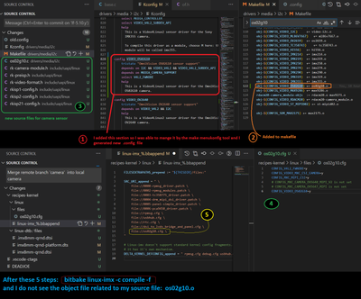

For me the second solution is suitable. I made some tests, I assume that I have to see the object file after kernel rebuild. Below on the picture I described 5 steps I made. (additional I modified DeviceTree).
I have other hint and I made that one hint as the first and now Im going to combine your hint with this one. What Im missing that I can not obtain the os02g10.o file after bitbake linux-imx -c compile -f  ?

Did you add your own kernel's configuration to DELTA_KERNEL_DEFCONFIG ? Also, I wonder if DELTA_KERNEL_DEFCONFIG_append exist ?
Khang
14,110 Views
btarnowski
In my project there is only DELTA_KERNEL_DEFCONFIG_append
I added
os02g10.cfg but still not see os02g10.o after build.
So now I need to study the use of DELTA_KERNEL_DEFCONFIG and why other functionalities works only with DELTA_KERNEL_DEFCONFIG_append
14,103 Views
khang_letruong
Senior Contributor III
Hi @btarnowski ,
Are os02g10.c and the modified Makefile committed to the repository or added as patches ? Btw, you can do bitbake virtual/kernel -c menuconfig to ensure that the CONFIG_VIDEO_OS02G10 is available and selected.
K

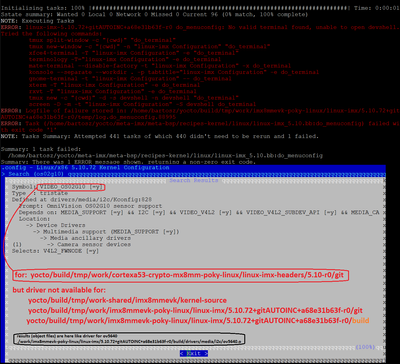

Looks like I need to generate patches for all added files: all header files and one source file os02g10.c
regarding menucofig tool:
1. bitbake virtual/kernel -c menuconfig - is not working as below on the picture
2. make menuconfig - works but I see 4 git repositories, I added os02g10.c and other files only to one of them - yocto/build/tmp/work/cortexa53-crypto-mx8mm-poky-linux/linux-imx-headers/5.10-r0/git
for these I did not add
yocto/build/tmp/work/imx8mmevk-poky-linux/linux-imx/5.10.72+gitAUTOINC+a68e31b63f-r0/git
yocto/build/tmp/work/imx8mmevk-poky-linux/linux-imx/5.10.72+gitAUTOINC+a68e31b63f-r0/build/source
yocto/build/tmp/work-shared/imx8mmevk/kernel-source
Im confused that there are 4 git source repositories
It might be due to the fact that you ran the command within Docker.
K
