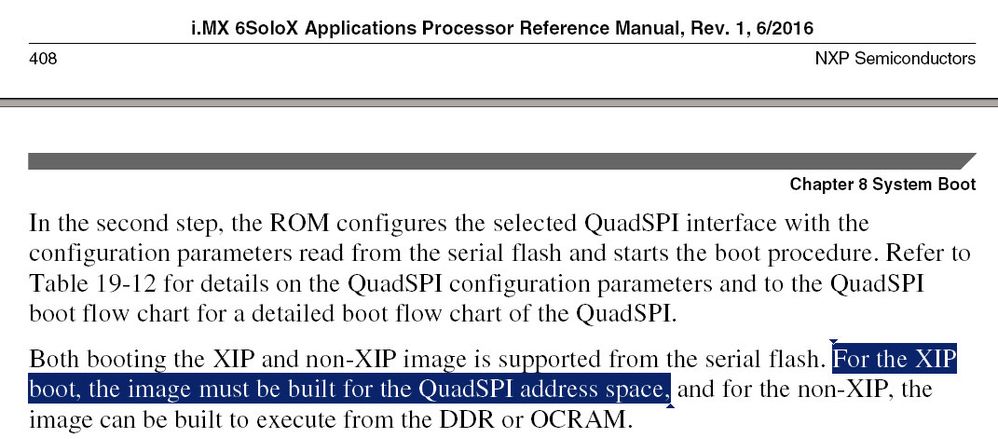

hello there!
I use MCIMX6SX4_A9.
I want to clarify some points when qspi boot mode implements.
I realaze that even if an uboot image is created with BOOT_FROM qspi and it will be set at right place on a flash device, there would not be XIP boot process while IVT data structure (entry) points to RAM.
(am i right? i suppose in case of xip, the entry have points to flash address)
i would to know how works the engine that swich load proccess to XIP and is it connected with uboot ld file?
Thank you.

Hi Oleg
yes this understanding is correct and Reference Manual states
igor
