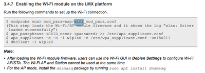

I want to test wifi in debian 12 based on 6.6.52 kernel.
after this command connmanctl, if i give enable wifi it is showing wifi not available.
i copied the linux source from fexbuild , compiled the standalone method.
below difference is observed between the standalone compiled .config and debian compiled .config.
the standalone compiled .config is including the wifi related configs and my flexbuild compiled .config is not including the configs
what is the reason for this .
how to test wifi in imx8mp in debian

Dear @Neha_V ,
i.MX8MP-evk's default debain 12 system supports NXP Wi-Fi , which is described in the document.
https://www.nxp.com/docs/en/user-guide/UG10155-Debian-24.12.pdf
As for which Wi-Fi chips are supported, you can can check corresponding firmware in the /lib/firmware/nxp folder. Wi-Fi driver supports multiple Wi-Fi chips,when loading driver, it will load correct firmware according to Wi-Fi ID.
Thanks!
