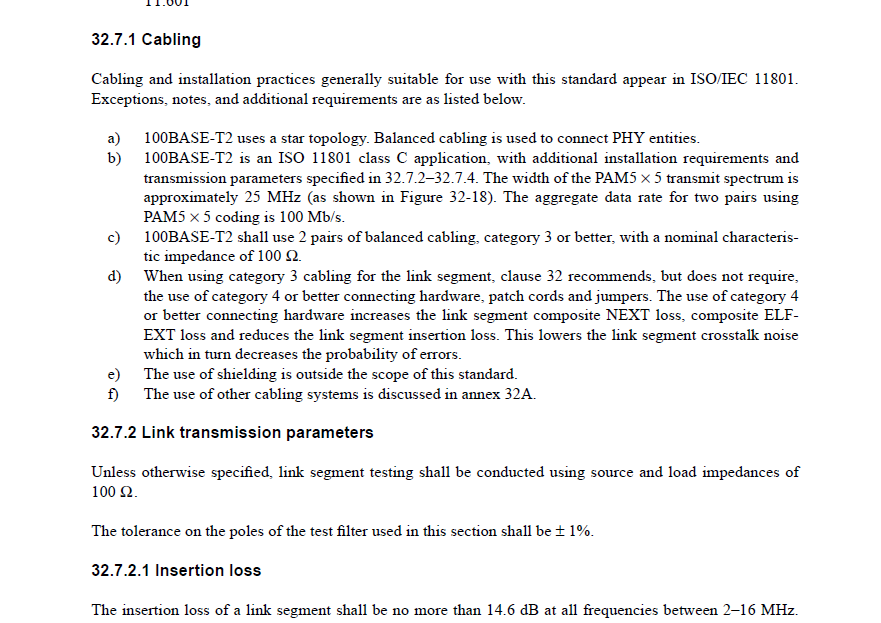

We respect the common knowledge in IEEE spec. not others' articles.
In the spec, only says the impedance not a certain terminal resistors.
BTW, in IEEE spec, it also respects to the spec ISO 11801.
several ways to achieve the impedance.
"it's part of impedance matching technique." ---  only put terminal resistors can do the matching?
It is one of impedance matching technique. not "part of".
In the i.MX8MM hardware design guide, already mention the layout impedance.  read the hardware design guide and finish your own design.
Copy some in IEEE spec. and please read the IEEE spec carefully. and found what you need.
and do not quote any articles but spec.
If you still have questions, please quote  IEEE spec and say it is wrong. and we will check it.
please read   IEEE spec. and others' articles could be under their certain context.

that you quote above   is their case, and they also refer to their ''design.
and the authors of those articles/document, they never say it is common knowledge. they said "Designers should check "
Where is the  "common knowledge" you mentioned, please show the spec.
Just i.MX8MM don't need termination resistors for MII data lines is very equal to in the article need termination resistors.
But they all respect IEEE spec.
