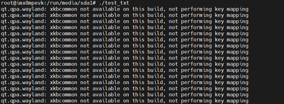

Hello,NXP support
IMX8MP of the platform I am using,the Yocto version I am using is 5.10.35. I have added libinput and libxkbcommon to the Yocto file system, but when I run a QT program and want to use keyboard input, the following error will appear when I tap the keyboard,How to solve this problem
qt.qpa.wayland: xkbcommon not available on this build, not performing key mapping

Hi @logic887
Thank you for contacting NXP Support!
Are you trying on the i.MX8MP EVK or a custom board?
Did you build the imx-image-multimedia in Yocto?

logic887
I am using imx-image-full in yocto,i.MX8MP Our own baseboard,Open the Yocto command line terminal and browser keyboard input is normal,but when I run a QT program and want to use keyboard input, the following error will appear when I tap the keyboard

brian14
Hi @logic887
Thank you for your answer!
I think this community thread can help you to resolve the issue:
qt.qpa.wayland: xkbcommon not available on this build, not performing key mapping - NXP Community

logic887
I have tried this method, compiling libinput and libxkbcommon into Yocto, but it didn't work
