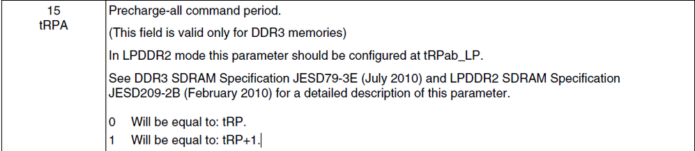

How to decide a tRPA parameter in script aid ?
I'm setting a i.MX6SL's DDR3 parameters and using following script aid.
i.MX6SL DDR3 Register Programming Aid
I can't find any description and data about tRPA in DDR3's datasheet and find only following description in i.MX6SL's reference manual.
But I can't understand which setting is suit for DDR3.
I also checked a DDR3 SDRAM Specification JESD79-3E (July 2010) but can't find any description about it.
I attached a DDR3's datasheet.
So could you point where it is in attached datasheet ?

  if the tRPA (PREA) is not provided in DRAM datasheet, one can
set it as tRP or  tRP+1 for assurance.

I understand as follow.
User can set it whichever user like if it not describe in datasheet.
User need test both of parameters, right ?
Ko-hey
5,270 Views
Yuri
Yes, users can try both cases : tRPA = tRP and tRPA = tRP+1
~Yuri.
