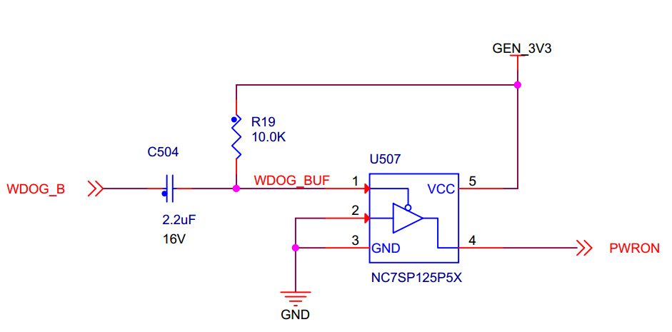

when I use the 3.14.52(kernel), imx6D7CVT08AD use the watchdog 2 to reset the system , I encounter the same issue,
the hardware : the net WDOG_B connected to GPIO_1
the issue discription:
   1#:  execute ./wdt_driver_test.out 1 2 0,the system is not reset,but I got the messige line :
snvs-secvio 20cc000.caam-snvs: Unhandled Security Violation Interrupt 2 = Watchdog,
so then I execute ./memtool -16 0x20c0000=0x34 ,the same messige print.

so make the dtb and download ,then execute ./wdt_driver_test.out 1 2 0,and ./memtool -16 0x20bc000=0x34 ,is work ,the system restart,
question :
1. the WDOG1&2 used same driver so they have some difference ?
2. I connect the WDOG1 to any PMIC pin why its can restart the system ?
3. I want to use the WDOG2 to restart the system ,could you tell me how to do this .
thanks!!!

Please try to test in the uboot and linux by setting the register directly.
It can iosolate the software issue.
And which watch dog you are using? watch dog 1?

#1  make sure the power cycle has no such issue
#2  SRS bit and related hardware design to make sure the pmic is reset by watch dog reset.
#3 measure the power supply when hang. please make sure the pimc supply is at the initial status at the reset. and uboot is set the ldo by pass or ldo enable for linux kernel.
20,357 Views
20,358 Views

WDOG1_RESET_B_DEB is the watch dog to tell outside usually pimc the system will reset.
The pmic will receive the signal and get reset as well.
You can see that hardware design in the reference design.
And that is why I ask you to check the power supply when issue is happening.
ldo bypass could not be used in the 1.2G part.
