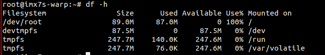

Currently, I finished setup for WARP7 (following manual: Warp7 User Manual | element14 | WaRP7 )
When I copy Qt framework from PC to WARP7, there is not enough disk space to copy.
As product introduction said:
  • Memory: 8GB eMMC 5.0 and 512MB LPDDR3
But when i check with "df -h" command, I get as below
Questions:
- where is WARP7 remain memory  ?
- If there are alot free space, how can I use it ?
Note: I'm very new to Linux & Embedded :smileyhappy:

Solved.
1. run "ums 0 mmc 0" in Uboot mode to access WARP7 on PC
2. run "Disks" on PC and allocate disk space for WARP7
3. start burn Yocto image to sdcard on partition that i allocated in step 2 (in my case, it is /dev/sdb2)
4. reboot
