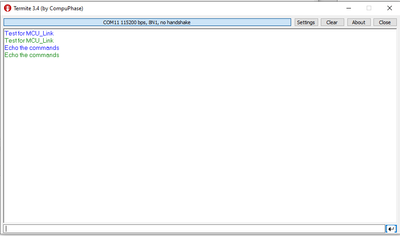

MCU-Link UART ports are detected as following when MCU-Link Pro debugger is connected to my laptop.
COM11 port in loopback mode (with J19 Purple and Grey ones UART Tx and Rx connected.

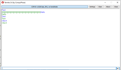

 COM 19 is working in loop back as well.  But for my exercise I have tried to use both COM 11/19 anyway for the NXP MCU Boot utility.
What I have noticed is I am able to use VCOM2 (COM 19) to detect the HW through the NXP MCU Boot utility tool but some how the VCOM p(COM 11) doesn't still detect the HW when I tried to use it along with the boot utility. Could you please explain this behavior ??

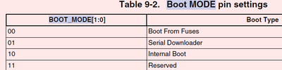

Did you configure the boot mode pins in 0001?

Yes, the obvious ones are ruled out, as the boot mode pins are in "00" Boot from eFuses and the eFuses are programmed to boot from Flash, while the Flash is erased. So in effect the ROM boot loader is put to "Serial downloader " mode. I am able to get the J26 (VCOM2) working but NOT the VCOM1 @ J19. Could you pls explain why this is the case ?

  • If set to Boot From Fuses, the boot flow is controlled by the BT_FUSE_SEL eFuse value.
    If BT_FUSE_SEL = 0, indicating that the boot device (for example, flash) was not
    programmed yet, the boot flow jumps directly to the Serial Downloader.
  • If BT_FUSE_SEL = 1, the normal boot flow is followed, where the ROM attempts to boot
    from the selected boot device.
  • The first time a board is used, the default eFuses may be configured incorrectly for the
    hardware on the platform.
