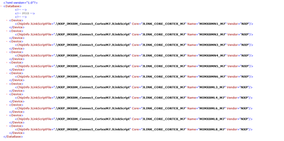

Are there any device-files to use with segger when debugging the M7 of an IMX8M Plus?
I'm trying to debug the M7 of an i.MX 8M Plus EVK, but run into trouble when trying to connect and reset.

one can try IAR and SEGGER tool patch for i.MX8M Plus devices
and SDK_EVK-MIMX8MP available on
https://mcuxpresso.nxp.com/en/welcome

Hi there, is there an updated solution, because this doesn't work properly or I'm doing something wrong.
I'm on Windows 10, using the J-Flash 7.86 version: There is no support for the MIMX8MPRM devices.. I alredy did what the readme of the file above told and also tried downloading the instructions of the J-Link page - debugger starter kit.
Therefore I put the files in following order in the %APPDATA%/../SEGGER-folder:
I also changed the .xml file:
It would help me a lot if anyone know further details or can reach me a hand!
