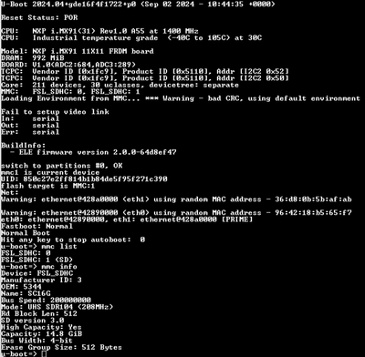

I can boot u-boot without the error message.
The u-boot device tree should be the next:
&usdhc2 {
	pinctrl-names = "default", "state_100mhz", "state_200mhz";
	pinctrl-0 = <&pinctrl_usdhc2>;
	pinctrl-1 = <&pinctrl_usdhc2_100mhz>;
	pinctrl-2 = <&pinctrl_usdhc2_200mhz>;
	vmmc-supply = <&reg_usdhc2_vmmc>;
	bus-width = <4>;
	non-removable;
	status = "okay";
	no-sdio;
	no-mmc;
	pinctrl_usdhc2: usdhc2grp {
		fsl,pins = <
			MX93_PAD_SD2_CLK__USDHC2_CLK		0x1582
			MX93_PAD_SD2_CMD__USDHC2_CMD		0x40001382
			MX93_PAD_SD2_DATA0__USDHC2_DATA0	0x40001382
			MX93_PAD_SD2_DATA1__USDHC2_DATA1	0x40001382
			MX93_PAD_SD2_DATA2__USDHC2_DATA2	0x40001382
			MX93_PAD_SD2_DATA3__USDHC2_DATA3	0x40001382
			MX93_PAD_SD2_VSELECT__USDHC2_VSELECT	0x51e
Result:
U-boot booting without error from SD card
If you want to boot from SD card there is not needed the cd function since the SD should not be disconnected from the board.

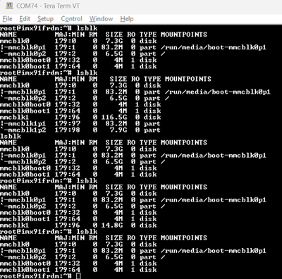

I made the next changes in Linux Kernel device tree and the card detection is working good without CD gpio configured:

Result:
Booting from MMC the SD cards are detected and mounted in the system without errors
