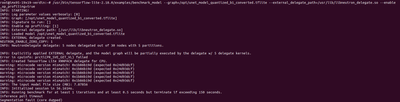

The i.MX95 board is flashed with latest Linux Bsp L6.12.3-1.0.0_MX95 . Tried executing Unet using benchmark_model after converting using the int8 tflite to TFLite for Neutron using model tool from eiq toolkit. The conversion was successful but on running the model using NPU with the following command:
/usr/bin/tensorflow-lite-2.18.0/examples/benchmark_model --graph=/opt/unet_model_quantized_b1_converted.tflite --external_delegate_path=/usr/lib/libneutron_delegate.so
Got segmentation fault with the following logs:
But the Neutron Graph layer which is causing the issue was formed on conversion to NPU supported tflite. So how can I proceed.

PoojaSk
Also please don't consider the previous log, I think it was because the model was converted to NPU supported format but delegate was not specified. This is the exact log with command I used for execution. The model is converted using steps mentioned in previous comment and I am getting segmentation fault. with verbose=1 didn't find the exact issue

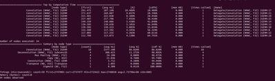

PoojaSk
Hi @Chavira
I tried converting the Pytorch model of Unet using the documentation. But after that on converting to TFlite for Neutron using eIQ tools, there is no difference in the layers, the same model is saved as the converted one. Was able to execute the converted tflite using NPU, but as per documentation it is the neutron graph node which is executed in NPU rest of the operations falls back to CPU. But the model converted using this step lack these neutron graph node, so how can it be confirmed it uses NPU? I have shared benchmark logs and profiling logs for your reference.
