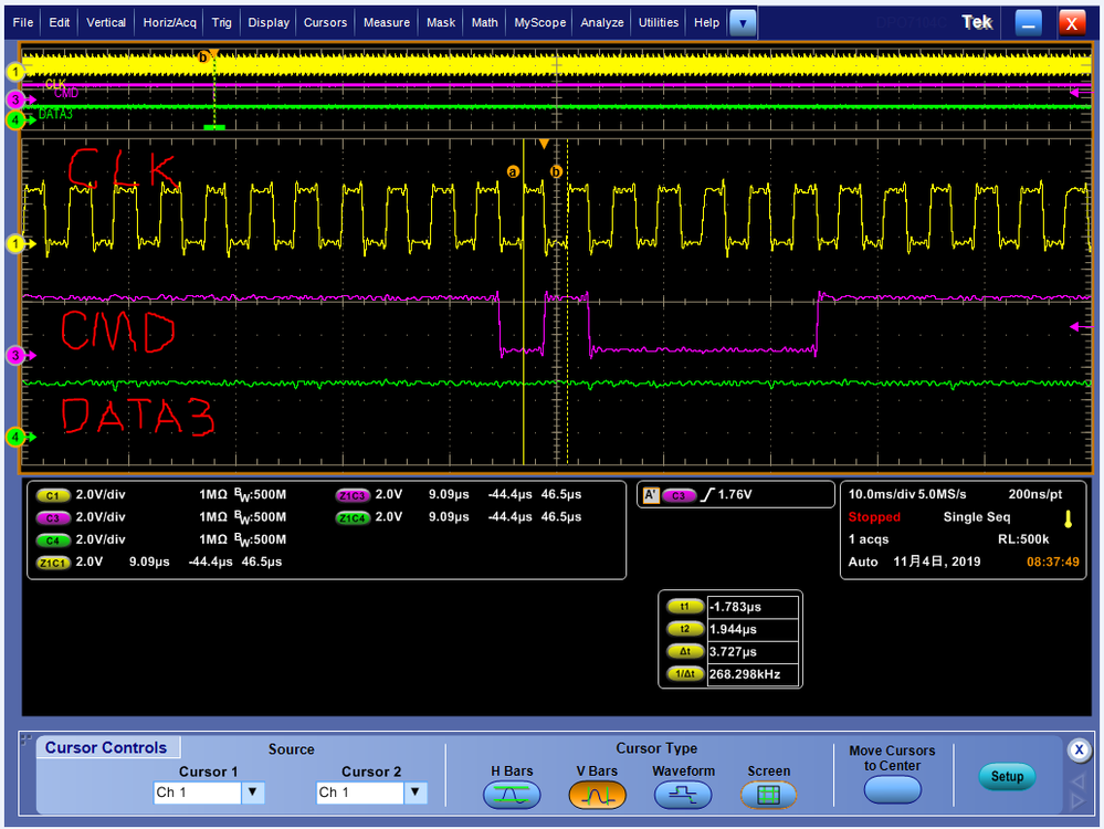

Hello!
When I use the eSDHC module,I try to issue the CMD0 commend to SD Card,one error was occur。
I am sure ,the I/O configuration is right, and the waveform,as follows:
Can see CMD0 send abort,and as the same time ,the bit 18 (CEBE)and the bit 17(CCE)of Interrupt Status Register (IRQSTAT) is ‘1’。
Can you give me some suggestion to save this problem?

Hi Sun
this may be hardware issue and one can try with baremetal sdk test
checking signals with oscilloscope
rt-thread/bsp/imx6sx/iMX6_Platform_SDK/sdk/drivers/usdhc at master · RT-Thread/rt-thread · GitHub
