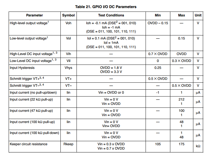

  As for voltages, please refer to table “General Purpose I/O (GPIO) DC Parameters” of the Datasheets.
~Yuri.
1,207 Views
ko-hey
Senior Contributor II
Which parameter is it ?
Could you specify which I need ?
Here is the example which is from IMX6DQIEC.
Ko-hey

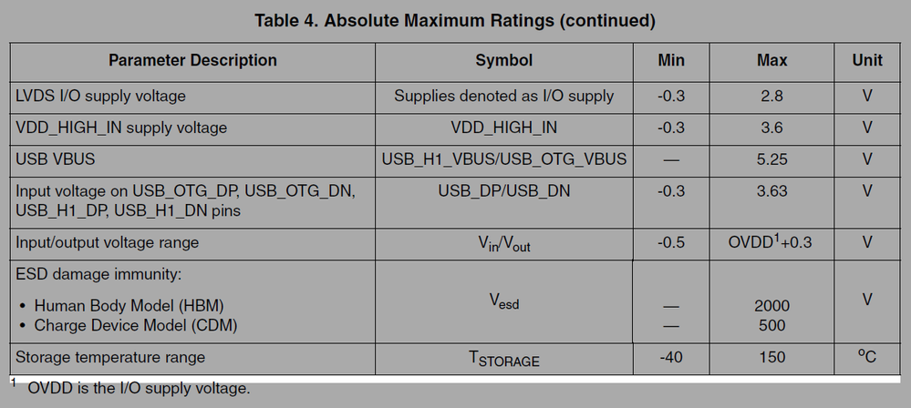

1,208 Views
Yuri
OVDD is maximum.
Absolute Maximum Ratings (not operational): from -0.5   till OVDD+0.3
Yuri.
1,207 Views
ko-hey
According to the Table 4 of IMX6DQIEC, the max of GPIO supply voltage is 3.6V.
So I think the max of OVDD is 3.6V.
Am I wrong ?
Ko-hey
1,207 Views
Yuri
 below we can find  input / output max voltage as OVDD + 0.3
Also two comments may be provided :
1.
  "These are stress ratings only. Functional operation of the device at these or any other conditions beyond those
indicated in the Operating Ranges or Parameters tables is not implied."
2.
  GPIO OVDD max = 3.6 V
Yuri.
