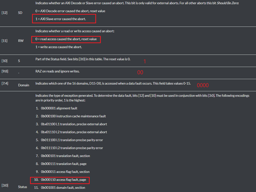

We are seeing  "Unhandled fault: imprecise external abort (0x1406)" error on iMX6 while running sleep cycle(suspend/resume). It occurs  ~1000 iterations.
problem is, It just print below logs then reboots.
Line 138581: kern.alert: [87658.479069] Unhandled fault: imprecise external abort (0x1406) at 0x7669d004
Line 138582: kern.alert: [87658.486144] pgd = a73d4000
Line 138583: kern.alert: [87658.488856] [7669d004] *pgd=00000000
Not sure which is causing this error.  is there any kernel flag to get more info ?
I've referred similar issues reported in this forum, all are having call stack, which are missing in our case.
https://community.nxp.com/t5/i-MX-Processors/Linux-kernel-crashes-at-spin-unlock-irq-when-suspending...
Any input to debug this issue are very much appreciated.

problem is we are not seeing complete backtrace when system crash, how to find which module causing this crash?
3,439件の閲覧回数
Zhiming_Liu
It's caused by hardware access memory, you can try to remove brcm driver and then test again.
