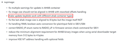

  • Device: mimx9352 (i.MX93).
  • SPSDK version: spsdk 3.4.0
  • Boot image layout: Bootable image with two AHAB image container sets:
    • Primary set: Container 0 (ELE), Container 1 (SPL DDR).
    • Secondary set: Container 0 -> image 0(BL31), image 1 (U‑Boot), image 2 (TEE).
  • DEK: 256-bit, key_identifier: 0.
Build works fine when DEK blob is in provided in YAML file; production-time ahab update-keyblob on flash.bin updates SPL only.
I have taken reference of https://spsdk.readthedocs.io/en/latest/examples/ahab/imx93/imx93_signed_ahab_uboot.html
How to select the secondary set/containers with update-keyblob? Is multi-set bootable image supported by this command? Recommended workflow to update blobs for secondary set without full rebuild?

Hi @udayMouli
Would you mind to use latest SPSDK tool v3.5.0?
https://github.com/nxp-mcuxpresso/spsdk/releases
For the update-keyblob command usage:
https://spsdk.readthedocs.io/en/latest/apps/nxpimage.html#nxpimage-ahab-update-keyblob
The typical usage of update-keyblob:
https://spsdk.readthedocs.io/en/latest/images/ahab.html#ahab-update-keyblob
Zhiming
