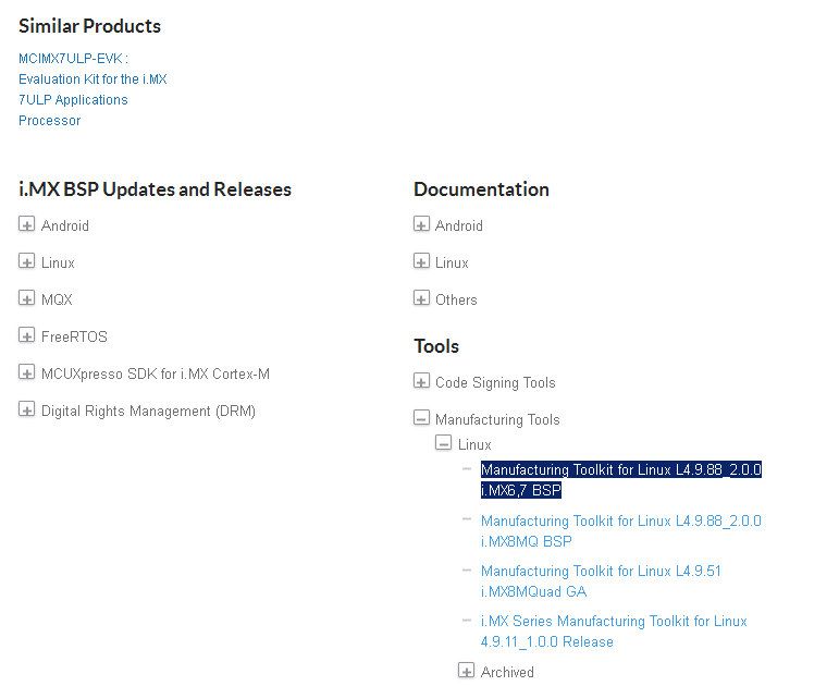

regarding "mfgtool_output.log.zip" - I noticed that you used Linux version 4.9.88 for it.
Note mfg tool package is linked to appropriate linux kernel and files in L3.14.52_1.1.0_ga-mfg tools
can not be replaced with files compiled with L4.9.88. Please look at link below
and use Linux version 4.9.88 Mfg Tool for files compiled with L4.9.88:
i.MX Software|NXP

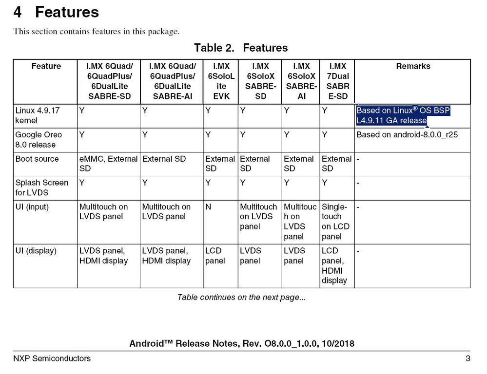

the same is valid for Android- for example latest Android O8.0.0_1.0.0 is based on L4.9.11 GA
according to Release Notes included in   Android O8.0.0_1.0.0 BSP Documentation
and only L4.9.11 GA should be used for compilation new mfg tool firmware.
