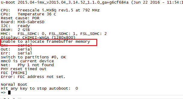

who can help me, i want to display logo when power on my board, i do the follow steps:
1.vi board/freescale/mx6sabresd/mx6sabresd.c
i modify the follow struct to add my lvds lcd timming
struct display_info_t const displays[] = {{
          .bus = -1
           .pixfmt = IPU_PIX_FMT_RGB666,
               .name = "CHIMEI-WXGA"
2. enable lvds0, my lvds lcd connect to lvds0.
reg = IOMUXC_GPR2_BGREF_RRMODE_EXTERNAL_RES
      | IOMUXC_GPR2_DI1_VS_POLARITY_ACTIVE_LOW
      | IOMUXC_GPR2_DI0_VS_POLARITY_ACTIVE_LOW
      | IOMUXC_GPR2_BIT_MAPPING_CH1_SPWG
      | IOMUXC_GPR2_DATA_WIDTH_CH1_18BIT
      //| IOMUXC_GPR2_DATA_WIDTH_CH1_24BIT
      | IOMUXC_GPR2_BIT_MAPPING_CH0_SPWG
      | IOMUXC_GPR2_DATA_WIDTH_CH0_18BIT
      //| IOMUXC_GPR2_DATA_WIDTH_CH0_24BIT
      //| IOMUXC_GPR2_LVDS_CH0_MODE_DISABLED
      | IOMUXC_GPR2_LVDS_CH0_MODE_ENABLED_DI0
      //| IOMUXC_GPR2_LVDS_CH1_MODE_ENABLED_DI0;
  writel(reg, &iomux->gpr[2]);
  reg = readl(&iomux->gpr[3]);
  //reg = (reg & ~(IOMUXC_GPR3_LVDS1_MUX_CTL_MASK
  reg = (reg & ~(IOMUXC_GPR3_LVDS0_MUX_CTL_MASK
  | IOMUXC_GPR3_LVDS1_MUX_CTL_MASK
  | IOMUXC_GPR3_HDMI_MUX_CTL_MASK))
     | (IOMUXC_GPR3_MUX_SRC_IPU1_DI0
        << IOMUXC_GPR3_LVDS1_MUX_CTL_OFFSET)
        << IOMUXC_GPR3_LVDS0_MUX_CTL_OFFSET);
  writel(reg, &iomux->gpr[3]);
but the i found the error "Unable to allocate freamebuffer memory", and i can't get the logo display. who can help me ?

Hi leavs
please check that following patch is included
[U-Boot] [PATCH v2] mxc_ipuv3: fix memory alignment of framebuffer
if that does not help please post this on uboot mail list
U-Boot Info Page
igor

Hi igorpadykov ,
     Thanks for your reply, I had checked it, my code had been patched, but it's not work.
