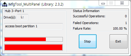

hi all
I did binary programming in emmc that connected SD4 with MFC Tool, but I did not succeed as below image...
debug message is
If you created or changed a DOS partition, /dev/foo7, say, then use dd(1)
to zero the first 512 bytes:  dd if=/dev/zero of=/dev/foo7 bs=512 count=1
(See fdisk(8).)
UTP: sending Success to kernel for command $ sh mksdcard.sh /dev/mmcblk0.
utp_poll: pass returned.
UTP: received command '$ dd if=/dev/zero of=/dev/mmcblk0 bs=1k seek=384 conv=fsync count=129'
UTP: executing "dd if=/dev/zero of=/dev/mmcblk0 bs=1k seek=384 conv=fsync count=129"
129+0 records in
129+0 records out
UTP: sending Success to kernel for command $ dd if=/dev/zero of=/dev/mmcblk0 bs=1k seek=384 conv=fsync count=129.
UTP: received command '$ echo 0 > /sys/block/mmcblk0boot0/force_ro'
UTP: executing "echo 0 > /sys/block/mmcblk0boot0/force_ro"
sh: /sys/block/mmcblk0boot0/force_ro: No such file or directory
UTP: sending Non-success to kernel for command $ echo 0 > /sys/block/mmcblk0boot0/force_ro.

igorpadykov
Hi Rhee
if this is custom board, then MFG Tool should be rebuild according to
board configuration, below link with similar problem
use mfgtool download imx6ql eMMC error | Freescale Community
igor
