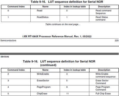

In the SPT 5.0 version, I extracted the fcb from the mcuboot image (Zephyr 3.1.0-release) and provided it as input in the userfcb option as below:
I get the error shown in the image above after uploading the user's FCB file.
Even with lower versions of SPT, they have the same problem as mentioned above.
Please advise on how to proceed with the "USER FCB".

1) Please advise on how to proceed with the "USER FCB".
-- Actually, the error message already illustrates the cause, the fcb.bin missing some LUT commands.
