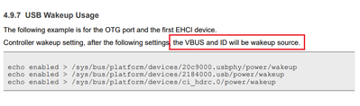

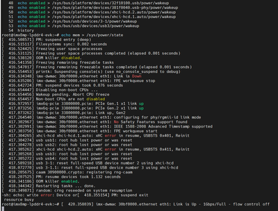

How do  you enable the wakeup function? If i use dr_mode = "peripheral", i can't enable wakup with sysfs.
Here are my test steps based on EVK.
1. DTS
&usb_dwc3_0 {
	dr_mode = "otg";
	hnp-disable;
	srp-disable;
	adp-disable;
	usb-role-switch;
	role-switch-default-mode = "none";
	snps,dis-u1-entry-quirk;
	snps,dis-u2-entry-quirk;
	status = "okay";
	wakeup-source; ///////////////////////////
	port {
		usb3_drd_sw: endpoint {
			remote-endpoint = <&typec_dr_sw>;
2. setting commands
Here the 3-1 and usbX is decided by kernel log.
[    5.467641] input: Dell Dell USB Keyboard as /devices/platform/soc@0/32f10100.usb/38100000.usb/xhci-hcd.2.auto/usb3/3-1/3-1.1/3-1.1:1.0/0003:413C:2010.0001/input/input1
echo enabled > /sys/bus/platform/devices/32f10100.usb/power/wakeup
echo enabled > /sys/bus/platform/devices/381f0040.usb-phy/power/wakeup
echo enabled > /sys/bus/platform/devices/xhci-hcd.2.auto/power/wakeup
echo enabled > /sys/bus/platform/devices/xhci-hcd.1.auto/power/wakeup
echo enabled > /sys/bus/usb/devices/3-1/power/wakeup
echo enabled > /sys/bus/usb/devices/usb3/power/wakeup
3, wakeup by keyboard.
You can check if there is any hardware issue about USB VBUS and ID pins.
Zhiming
