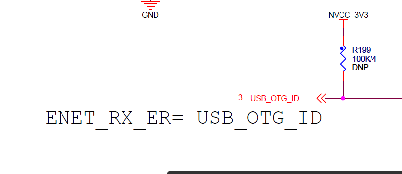

Hi Community,
I'm working on i.MX6 Quad sabre-SD and build Android 6.0 as my OS system.
I'm trying to designed OTG not only device mode but also a HOST mode.
The condition now is my OTG could burn image via MFGTOOL by connecting OTG.(Means my OTG could be device mode)
But my mouse cannot work if I plugin OTG.(Means my OTG could not be host mode)
Is that anything I need to be mentioned in DTS settings or driver settings or fstab.freescale?
Or my hardware designed issued?
Thanks in Advanced!

Hi tsung
USB_OTG_ID should be low in host mode, one can check this signal.

I've check when I want to be the host mode ID ping will not change to low.
It will still high.
Is there any settings I need to set?
Below is my DTS settings for ID pin
&usbotg {
vbus-supply = <&reg_usb_otg_vbus>;
pinctrl-names = "default";
pinctrl-0 = <&pinctrl_usbotg>;
disable-over-current;
srp-disable;
hnp-disable;
adp-disable;
status = "okay";
pinctrl_usbotg: usbotggrp {
fsl,pins = <
MX6QDL_PAD_ENET_RX_ER__USB_OTG_ID 0x17059
For hardware designed my ID pin will pull high, is this design correct?

Hi tsung
dts example can be found on
imx6qdl-sabresd.dtsi\dts\boot\arm\arch - linux-imx - i.MX Linux kernel
igor

igorpadykov
Thanks for your reference.
Now my OTG can be device and host.
But there is coming new issue.
Below is my hardware design for ID.
If I did not plugin otg, ID would be high because of the pull high design.
At this condition, my EIM_D22 USB power pin are not stable at low.
It changed low to high and high to low.
How can I fix this problem?
Is there anything I need to mentioned?
