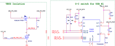

We are using a custom designed board having a standard USB host port (USB_H1) and USB OTG port terminated on a micro USB connector.
We are facing an issue in implementing the OTG Host mode when we are connecting the small micro usb cable convertor(USB  micro-B to USB TYPE-A female connector). Even VBUS 5V also doesn't not comes up.
To verify the functionality of the USB_OTG_ID pin we have probed the pin and got fair results:
  >> While connecting the small micro usb cable converter (USB  micro-B to USB TYPE-A female connector)  :   USB_OTG_ID Pin -> 0
  >> Normally during the Device mode functionality    :  USB_OTG_ID Pin -> 1 ( 3.23V as we have PU with 100K)

sumit8915
Hi Igor,
We have verified how VBUS is produced on i.MX6_SABRE_SDP_DESIGNFILES​.
We are also generating the same way using a Current limit switch. Here is our design :
NOTE: Here USB_OTG_PWR is connected to the Micro USB connector and USB_OTG_VBUS is connected to the OTG VBUS Pin.
to verify the HW we are making USB_OTG_EN pin as 0(GPIO) and USB_OTG_PWR comes up as 5V.
But as per the OTG functionality USB_OTG_PWR should also comes up when we connect the small micro usb cable converter (USB  micro-B (with ID pin GND) to USB TYPE-A female connector) so that we can connect a Peripheral device on the Type A connector of this cable.
